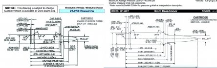

What you think abaout my intention to cercover nice brass for 22-250 out of 6mm Creedmoor SRP brass?.
Since nobody makes SRP on 22-250 brass i'm want to try it with the 6mm Creedmoor which is now available from Lapua at decent price.My only doubt is if the Redding body type of 22-250 will be able to take down the body close to the shoulder. Many thanks for any useful advice
The upper portion of the case should size down just fine with some Imperial Wax. Where you may have trouble is near the base. The 22-250 chamber shows to measure .467 at the 200 mark. The Creedmoor chamber shows to be .470, so the brass may be larger in that area and your die may not take it down far enough.

Thanks lot for your advice , i didn't realized the difference in the base area at my first look of them

Ive got some Peterson 22 Creed SRP brass coming for my 22-250AI. The chamber has a web of 468. The Peterson is 467 at web so will be giving that a shot.
