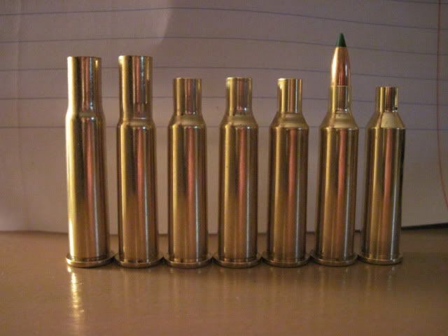

I posted this over on Saubier.com to show how I make brass for my .204 Wasp. If you trimmed #5 to 1.813 it would be ready to load and fireform in a .219 Wasp. Probably wouldn't need to neck turn, I didn't for my .219 #3.
forming brass
I finished some brass today and fired the first two breakin shots out the back door into a tree in the back yard. Hope to make it to the range Mon or Tues depending on the weather.
I thought I'd post a pic of my forming progression. I know I like reading about wildcats and case forming, so I hope some of you will enjoy seeing mine.
1 30-30
2 1st die, .325 dia.
3 2nd die, .284 dia, trim to about 1.820 length
4 3rd die, .260 dia.
5 FL .219 Wasp die, .2223 expander(makes a good fit on my neck turner pilot), neck turn to .245 dia
6 .219 Wasp NK die with .237 and then .228 bushings, trim to 1.770 length, loaded with 31.0gr Varget and 39gr BK
7 fireformed .204 Wasp
I made the form dies almost 20 years ago when I was a tool and die maker and had access to some really nice machinery. The 1st die was a .44 mag seater that I inserted. The 2nd and 3rd were .225WW dies that I opened up the neck dia. and changed the shoulder angle with a wire EDM and ram EDM. The Redding neck die was converted to a bushing by JLC Precision.
