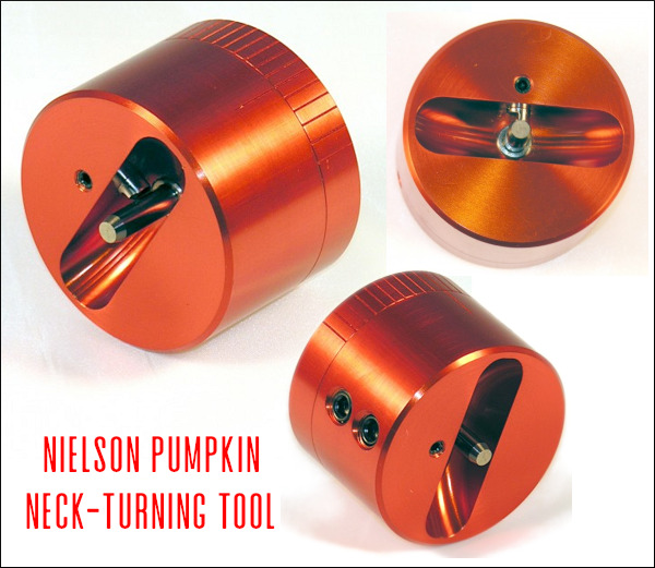

The big deal with the pumpkin is the precision and ease with which you can make very small adjustments. The mandrel is ground so that the part that goes into the case neck is very slightly offset from the part that secures it in the turner. The body of the turner is two piece with the mandrel mounted to one that indexes it. It rotates within the other which holds the cutter and has a set screw to secure the mandrel's adjustment. The large adjustment is done by sliding the cutter, using a feeler gauge, and the tenths are handled by the eccentric mandrel. There is no slack in the system. Having said all of this, there are issues. The cutter and working part of the mandrel are down in a hole and if you cut by inspection this is a disadvantage. Also, chips do not clear as well. For those that are not familiar, here is the "pumpkin" turner.
