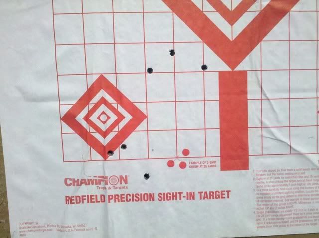

I have no trouble with the 55's with a 9 twist from my 20br, I haven't shot many coyotes with it but the one I did shoot dropped like a stone at 300yrds with no exit hole, I was very impressed with the 55's on groundhogs also but mine is much to heavy for a coyote gun and I didn't have much luck getting it to feed so I had much lighter rifle built a 20-250 with a 9 twist it also shoots the 55's great.
20br 5 shot 100yrd group with the 55 Berger's
20br 2 500yrd 3 shot groups not the tightest but ok for shooting off the top of my truck
