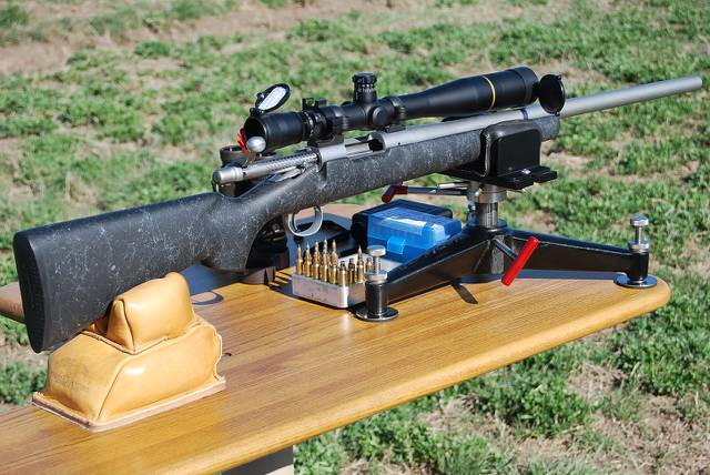

The Pac-Nor print Tommie shows above in Post #2 is mine that I modified slightly from Todd's original 204 Match chamber. Mine has .015" freebore vs the .062" FB that PN will use if not requested otherwise. Just be aware if you use this or a similar reamer design, shooting factory ammo in this chamber is not recommended.
I had Dave Kiff at PGT grind my 204 Match reamer for my M700 11T build. The rifle shoots lights out.
Beautiful gun. I am leaning towards doing a barrel swap on my Savage .204 with your specs or maybe a 10 twist. We shall see how far I go once I finally get off my butt and load some rounds for my GreTan Remington .204. In any case I want to start loading for my Dakota .243 in the future as well. Kids are older (graduating high school) and not taking as much time out of the schedule as the last few years. I finally have space in the new house to setup my bench and do what I want now as well.
Rick, what bullet/seating were you intending to run when you had that reamer dimension changed?
RR, in that rifle, the bullets of choice are the Nosler 32gr BT and Vgdn, and the 39gr SBK, mostly the 39gr as the rifle is my LR rat rifle for work past what my 221FB and 20VT are usually used for; work past 400 yds.
With that chamber, I'm able to reach the lands with all bullets mentioned. I get .2" groups with .080" off the lands, all the way down to .005" off the lands. The 204 is indeed very accurate even with ridiculous jump distances of .100"; SAAMI factory dimension.
