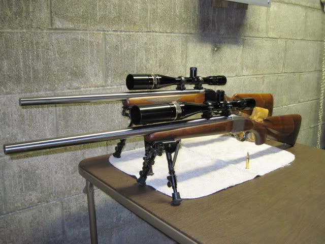

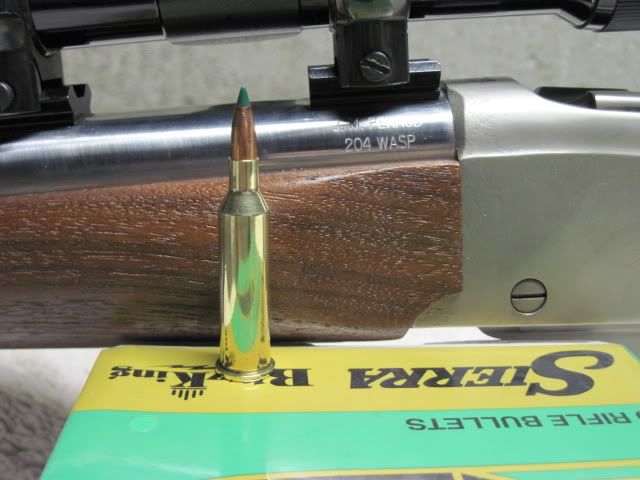

When I ordered my .204 Wasp reamer from PTG in June,08 Dave Kiff told me they already had a design named .20 Wasp so I named mine the .204 Wasp. I moved the shoulder .003 forward of the long version .219 Donaldson Wasp to make sure that I could form the shoulder with my .219 FL Redding die. Case length is 1.770 and the neck is .232 dia and .250 long. It holds 32.5gr of Varget. I was looking for velocities close to a .20BR and I'm getting 4000+ fps with 31.0gr Varget or N140. Here is a pic of a loaded round next to the No.3 and a pic of both rifles.

I bought a box of 1000 pieces of R-P 30-30 brass, formed a few of them and seated a bullet before deciding on what neck dia. on the reamer to order. Loaded rounds measured .232 so I figured they would clean up when I turned them to .229-.2295. I've had good luck with necks about .012 thick before and the necks cleaned up at least 90%. Here is a pic of my forming process.
1 30-30
2 1st die, .325 dia.
3 2nd die, .284 dia, trim to about 1.820 length
4 3rd die, .260 dia.
5 FL .219 Wasp die, .2223 expander(makes a good fit on my neck turner pilot), neck turn to .245 dia
6 .219 Wasp NK die with .237 and then .228 bushings, trim to 1.770 length, loaded with 31.0gr Varget and 39gr BK
7 fireformed .204 Wasp
I made the form dies almost 20 years ago when I was a tool and die maker and had access to some really nice machinery. The 1st die was a .44 mag seater that I inserted. The 2nd and 3rd were .225WW dies that I opened up the neck dia. and changed the shoulder angle with a wire EDM and ram EDM.
My Redding .219 Wasp neck die was converted to a bushing die by JLC Precision in Iowa. I use a Forster case trimmer and neck turner.
I turned the necks at .22 cal. because I didn't have a .20 pilot at the time, only took a couple of trial cases to get the neck turner set up. I bought WW brass for my second .204 Wasp so I could keep it seperate. The WW brass is heavier and I've had to reduce powder charges about .5gr.

A .20/30-30AI would be close to a .20-250, good for coyotes and such, maybe a bit much for a PD or ground squirrel shooting. I really like the capacity of my .204 Wasp, a little more than a .204 Ruger, close to a .20BR. I've actually backed off to about 3950fps for my PD load with the 39gr BK. I've had it up to 4150fps without pressure signs. I bought 500 32gr Zombies a while back. Going to try to find a .20VT type load for the close shots. Maybe extend my barrel life with the light load and the were cheap. Here's a couple more pics.

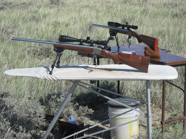

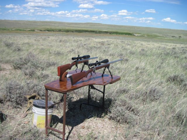

L to R My rifles and ammo right before I left for Montana last June.
No.3 .223, bought it at a gunshow a year ago, needs a new barrel.
No.1 .219 DW PDK, Shilen 14"tw, 8-32X40 Bushnell 4200
No.3 " , Shilen 8"tw, 6.5-20x40 Leopold
No.3 .204 Wasp, Krieger 11" tw, 6-24x42 Sightron SII Big Sky
No.1 " , Pacnor 11" tw, 6.5-20x40 Leopold
They all have Kepplinger set triggers, The scope on the .223 is a Premier Reticle 18-40 that I had just bought and wanted to see how it would do out on the prairie.
The dogs were pretty skittish at this town, shot a few under 200yds with the .223 when we first got there, then it was the No.3 .204 on dogs 3-400yds to the left and the No.3 .219DW PDK with 75gr A-Max on the dogs 5-600yds on the other side of the pond. Can't wait to get back out there.
