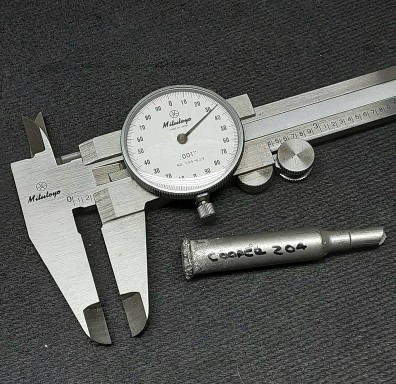

I'm using a Redding Comp Seater for my 20VT with no issues. My Cooper M38 also has a chamber neck ID of .234", as does my Cooper M21 204R. I'm using turned brass from R-P, Nosler and Lapua.
Confused about exactly what ID my rifles had, a chamber cast with Cero-Safe told the story......234"
