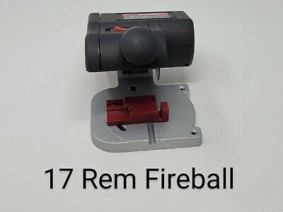

If your going to make over 100 cases, harbor fright has a mini chop saw. There are 3D printed jigs for chopping brass off. Well worth the money.
Thank you all for the feedback. This is strictly going to be a range gun for me and my young son, when he's old enough to shoot. I'd prefer to do Lapua brass if I can. I've watched a youtube video about chopping off the brass and its way beyond my experience as a reloader (i'm fairly new) but I don't mind doing it. Can you tell me more about the 3D printed jig or do you have a link?

The photo below shows (1) Harbor Freight mini-chop-saw. and (2) the 17/221 FB jig you install. Those are normally available on Ebay.
