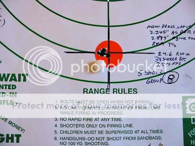

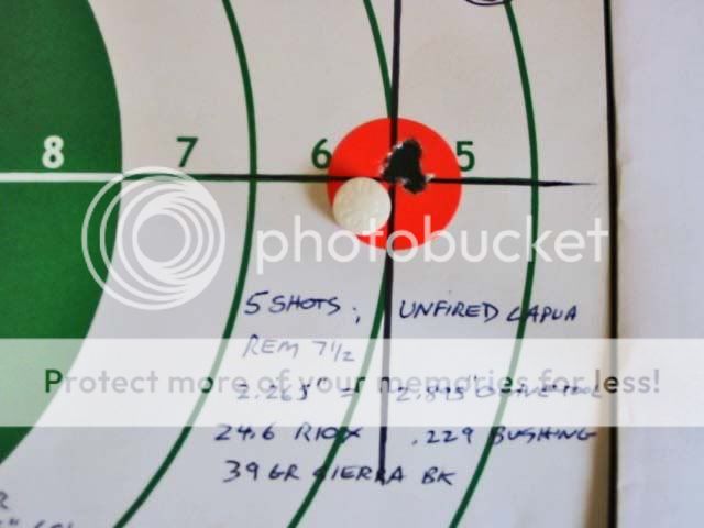

Only fired a few dozen shots through my 20 Tactical, so I can't tell you about the longevity of my Lapua brass. But in a 1-11 twist PacNor barrel, it has inherant accuracy that puts bullets in 1 hole at 50 yards, and 5 shots into 1/4" groups and less at 100 yards fairly easy using 39gr Sierra BK at 3,820 FPS. This is a Rem 700 action on an HS stock, and I couldn't ask for more accuracy. These are 100 yard targets;
