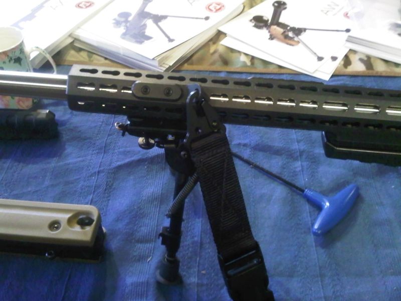

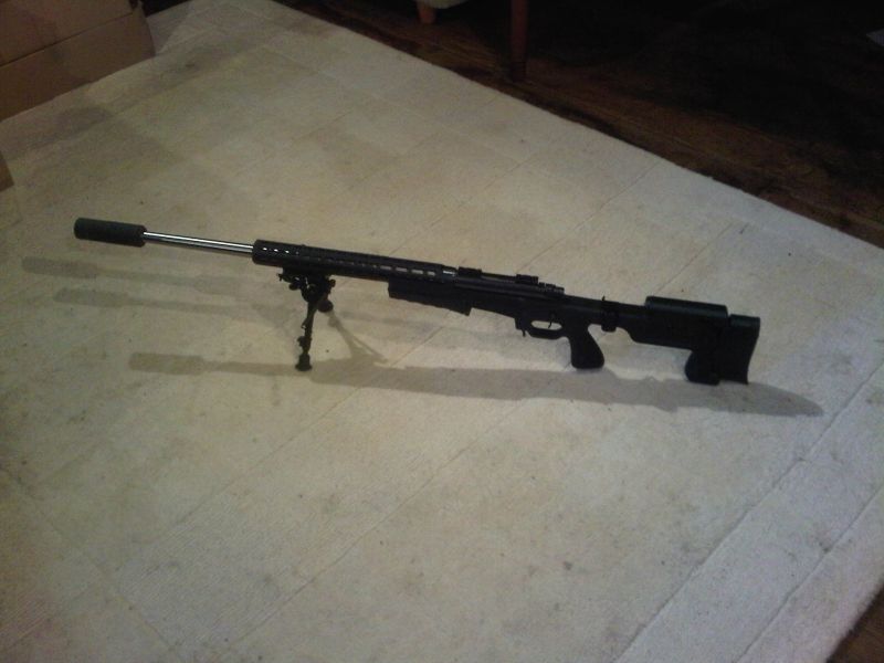

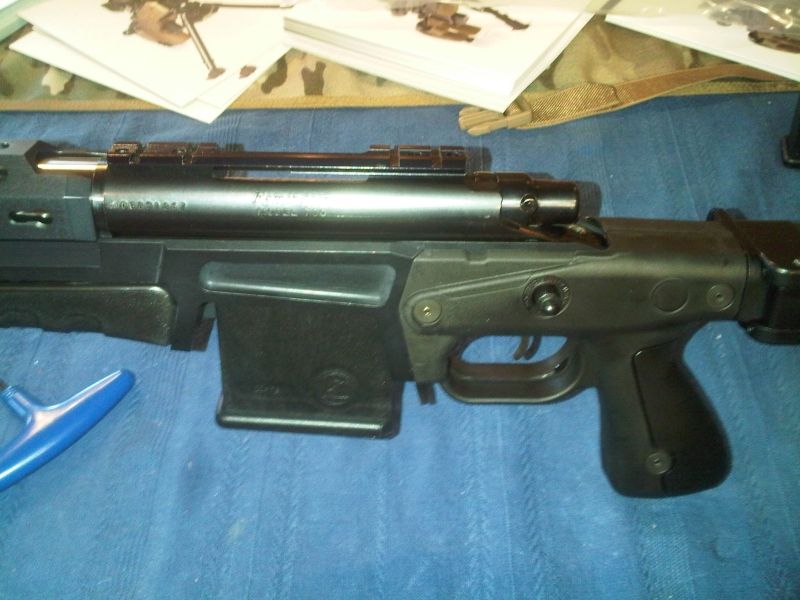

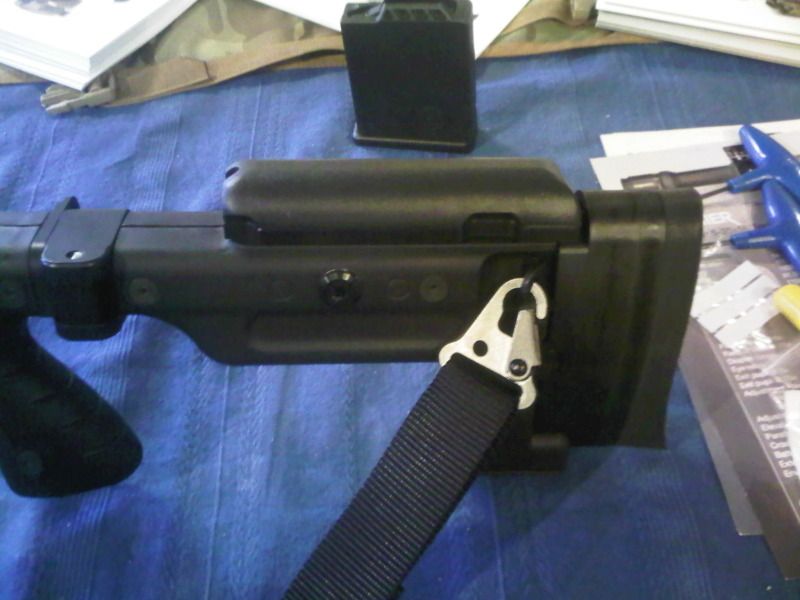

Well there she is, all ready to go just got to mount some glass get some rounds loaded up and see what she can do.
If you did go w/20 tac 12 tw., mine likes 24.3 benchmark w/39 sbk's imi cases and 71/2 rem. srp. Looks good, hope it shoots as good, Tom. Whose can are you using?
Hi,
its an ASE UTRA Jet Z CQB, and its also had a shillen trigger fitted, (from its old days as a .222) :-)
regards
nick
