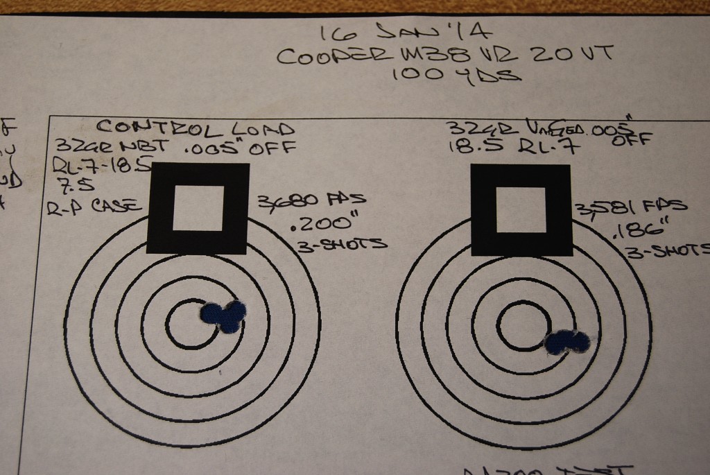

For all my .20 cal rat rifles, the best combination of accuracy and terminal results has been the Nosler flat base tipped 32gr Varmageddon, or the Ballistic Tip, not far behind.
Out of my Cooper M38 20VT:
And for a heavier bullet in about any .20 cal rifle, the 39gr SBK just can't be beat.
