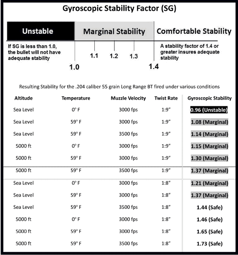

This gives an SG estimate of roughly 1.4 and at MV of 3650 fps there is no indication of a loss of BC performance out to 1000 yards at altitudes from 2625 feet above sea level or higher.
ETA: As @B23 points out in that Berger clip, the 1:9 won't work if you go into thick air, but the 1:8 will.
One has to be aware that twist, stability, BC, accuracy, bullets bursting, etc., are all trade-off issues and there isn't a simple answer. Berger's advice is 1:8 to keep you out of trouble in low altitude, thick air. The reason to take risks on less spin, is a longer discussion but it is important to understand before you select barrels and bullets.

Finally got an answer from Berger, they say go with an 8T which would probably be to cover the worse case scenario of low velocity and low altitude/dense air.
Chris,
We suggest the 1-8 twist for this bullet in 20 PPC and up cartridges. Barrel condition , length, copper and carbon fouling can also play a factor here.
Take care,
Phil Hoham
