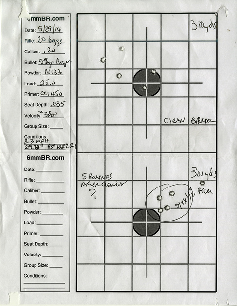

On another note- I did a "how many shots before I lose accuracy test" whereby I clean the rifle, shoot 5, let it cool, shoot 5 at another location on the target. The second group of 5 were much tighter than the 1st group. Like 4 shots inside 3/4" x 1/2" and one flier over an 1-1/2" away. The first (clean barrel) group was a box about 2" x 3/4". I was surprised the clean barrel did so poorly.

Personally I've never seen this before. I've only been reloading for about 15 years, maybe 20, so I don't have a big experience base
The top group is from a clean barrel. I mean I probably used 10 wet patches and a half dozen dry patches. When I was done there was pretty much nothing on the last patch.
I shot 5, the wind had laid down so this isn't wind related. I waited about 10 minutes then shot the lower group. There is one flier. I knew it was going to be bad. I've got a very light trigger and I touched the round off before I was ready. 4 shots at 300 inside of 3/8" x 1/2" is pretty not bad but why is it great after 5 rounds? I'm more used to shooting one fouling round and the rifle settling down. Maybe it's just how it is
