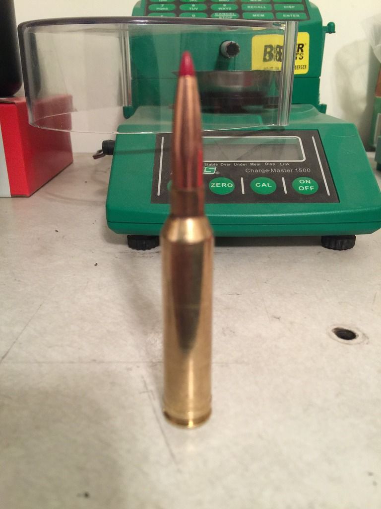

Mag? Got a box to try out. Here's one seated to my lands to touch. Measure at 3.530, still fits in my magazine to feed also. Mines a 1-9 twist. Gonna try a ladder with retumbo first then try some h4831sc since it's what I shoot with the 162amax

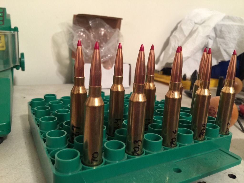

175s loaded up for a ladder test. Hopefully I can get it tomorrow before I go on nights.
Starting these on some new win brass. 70-72.7gr in .03 gr increments of retumbo. Seated at 3.525 base to tip. See how the print. Maybe next days off I'll run them over the crony

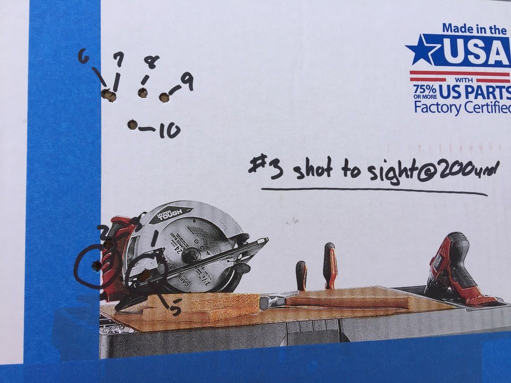

Went out and shot my ladder. Looks like I found a good spot to start seating depth with. No pressure sign and all easy bolt lift. Might take it farther up to 73.5 and see what it does. But for now I'm gonna work the 71.8gr charge
71.5, 71.8 and 72.1 are 6-9 shots.

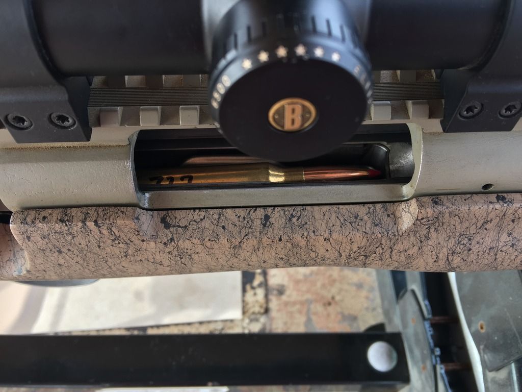

Here's the long round in my mag

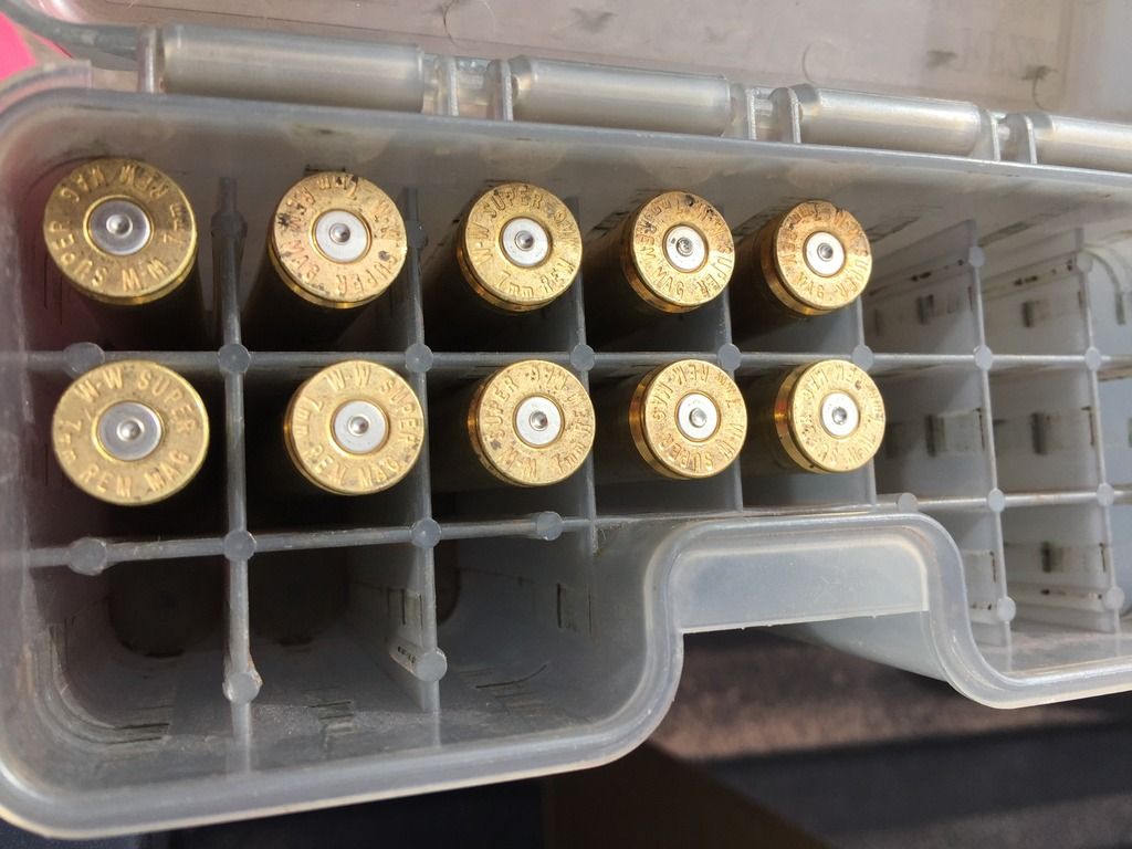

The brass
No pressure signs and visibly cratered primers? I think you may want to cronograph a load or two there. If I had primers that came back like that, I'd be backing down right quick. Word on the street is that Retumbo is temperamental when it finally does decide to spike.
None of them were cratered. Might just be the way the pic looks. They all look the same as my 162 amax loads do
