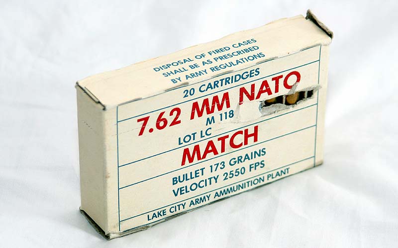

Find someone with an M1 or M1A who wants some inexpensive plinking bullets an sell them. Buy some Sierra 150/168/175 an work up a good load. Why waste powder and primers trying to make a "ball" bullet that at best will shoot 1 MOA maybe into a sub MOA bullet. The "Match" on the can denotes these were the type bullets loaded in LC Match ammo prior to the use of the Sierra 168's in the early 80's if memory serves.. It does not mean they are match bullets as we know them today. Collectors like to scoff this type stuff up.

These were the M72 / M118 match bullets. Earlier years production were top of the line high BC bullets for the late 50’s and 60’s.
