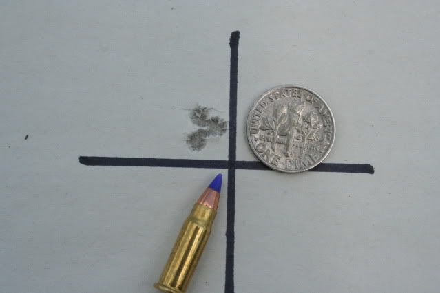

I have an Annie, A CZ and a converted 10-22 in 17mach2. All like Eley for accuracy & also used them for groundhogs & squirrels.

The Mach2 is the PERFECT tree rat round. I was slow to the party and kick myself now. Unbelievably universal, I have 2 CZ's and a Savage and they all shoot ragged holes at 50 yds.
Mine all prefer Ely, it's pure magic ! Shot GH's. PD's feral cats, etc with mine, it's the first thing I reach for around the farm.
