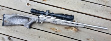

I must have gotten lucky (or blessed) to have gotten a good one. I purchased the B-mag with heavy barrel and laminate thumbhole stock. Stainless action and barrel. I put on a Glades bolt handle, and DIP top rail.
My friend purchased one of the first Savage WSM's with a skinny barrel, and it shot like crap. That was their first run, and they had issues, and they sucked, gave the caliber a bad reputation. The one I got was one of the newer ones, and it shot about .5" to .75" at first.
I bedded the action, and it then shot like a laser! It's got small rear area for bedding, and the rear part of the barrel has groves, so I bedded that area. The blue is Brownells release agent.

It's one of my most accurate rifles, but it depends on the ammo as well. Most of the time it shoots about .4" - .6" groups with Winchester, Federal or Hornady. Browning makes it now too, but I've never shot that.
First three round after bedding, at 83 yards, .07" group.
