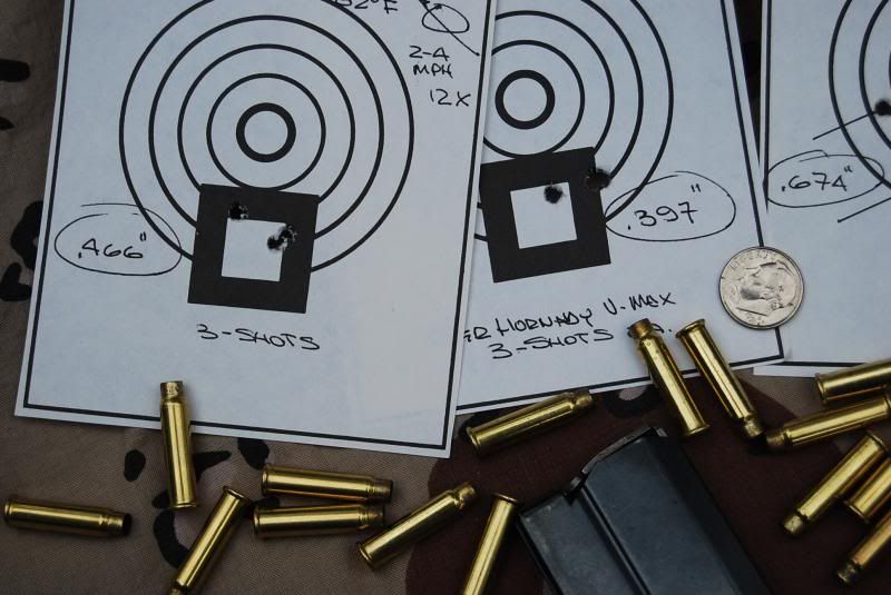

Here's some targets shot with my Anschutz....definitely NOT BR accuracy, but it IS sub-MOA and plenty good enough for ground squirrels and PD's......
I'm not aware of any sanctioned competitions that feature 17HMR's, but I've been wrong before. :)
