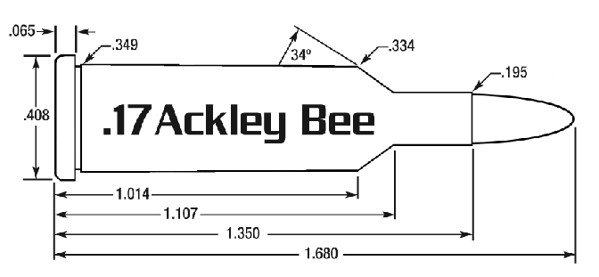

Does anybody have any information on a 17 Hck Bee cartridge? I have a reamer but would like to get a print and info on making brass. I think the brass is made from 218 bee but not sure.
You may be correct. The reamer was made by JGS in 1983 and the info is hand etched on the reamer. It looked like an "H" but after looking at it with a magnifying glass I think it is a poorly done "A", the top of the "A" is very faint. Does anybody have a print or know where to get dies?

I will call them Monday when I started this today they were all ready closed. My reamer measures up to everything on the print except the base to shoulder length. The print shows 1.014" the reamer measures .975"
Thanks for the help
I think the mystery has been solved. The drawing that PDS found on the internet is mislabeled. Attached is a reamer drawing for a 17 Ack Bee and Redding has confirmed their sizing die matches the reamer print.
The 17 Ack Bee has a base to shoulder length of .985" and a shoulder angle of 30 degrees
