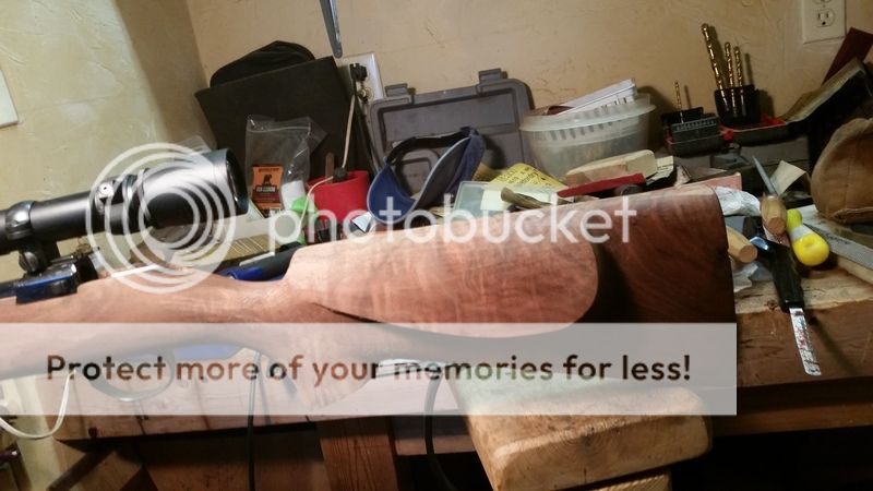

Got some time to work on the inletting an to start shaping the butt to a more classic shape. I put a scope on temperarially to see how the comb height was
