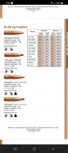

Hi guys.
Do any of you have an idea for me im trying to reload some Barnes ttsx 165 gr for my 30.06 but I cannot find any load with vithavorui or norma powder, is there anyone there can help?
Kind regards
Dennis

The 165 TTSX is too heavy for a copper bullet. They work better when you step it down to 150 gr ttsx because the faster they fly the better they work. If you already have the 165 ttsx that's ok, they will work.
I can only help you out with Quickload data...
Any other specific powder you want data for let me know.
I can't say this enough.. REDUCE & WORK UP.
It be best if you start at where it says -10 which means -10% from MAX.
And Quickload isn't always super accurate. Neither are Reloading manuals. There are many variables that affect pressures.
