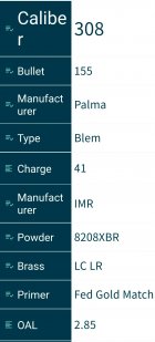

What are some of your loads using this combo? I have Hornady 155 bthps, Sierra 2155 and 2156 155 smks and the best group my gun has shot was with the Berger 155.5 full bores and 42.8gr of 4895, 2.800 COAL. I am using Starline small primer match brass and Federal Gold Medal match AR primers.
For whatever reason neither of the Sierra bullets have shot very good so far. Just looking for data points to compare against my own.
Everything I've tried so far has been loaded at mag length. I have a Krieger 20" M110 barrel, 10 twist. JP high pressure bolt and SA adjustable gas block.
Is 2750 a realistic velocity goal with this setup and 155s? So far have only reached the high 2600s.

I personally run them a bit slower, around 2650 out of a Criterion 20". I also use a JP bolt. There is obviously some lot to lot variance for H4895 - my go to load was 41.7 gr under either a Hornady 155 BTHP or Sierra 2155. This is with LC brass though hence the lower charge.

I scored a good deal on some 155 Berger hybrids so I figured I would give them a try and possibly rule them out, 43.5 H-4895 or VV-135 in a LC case, any good primer 2.82 coal run ok in my M14 clones however in my 7.62mm M1 they shoot freakishly tight.
Using your same 155 bullet, primer and brass, my best results, by far, came with Reloader 15. N140 was second most accurate. The Reloader 15 comes onto the shelves every few months, then disappears. Unless you have some to try - have to watch regularly.
H4895 is in short supply down here and many of the sling shooters are moving to 8208. The "old" recipe was 44.1g to 44.5g - which may be too hot for a gas gun. I gather that 44.8g of 8208 is the current favourite for about 3000fps = but again, work up - that is a bolt gun recipe.
