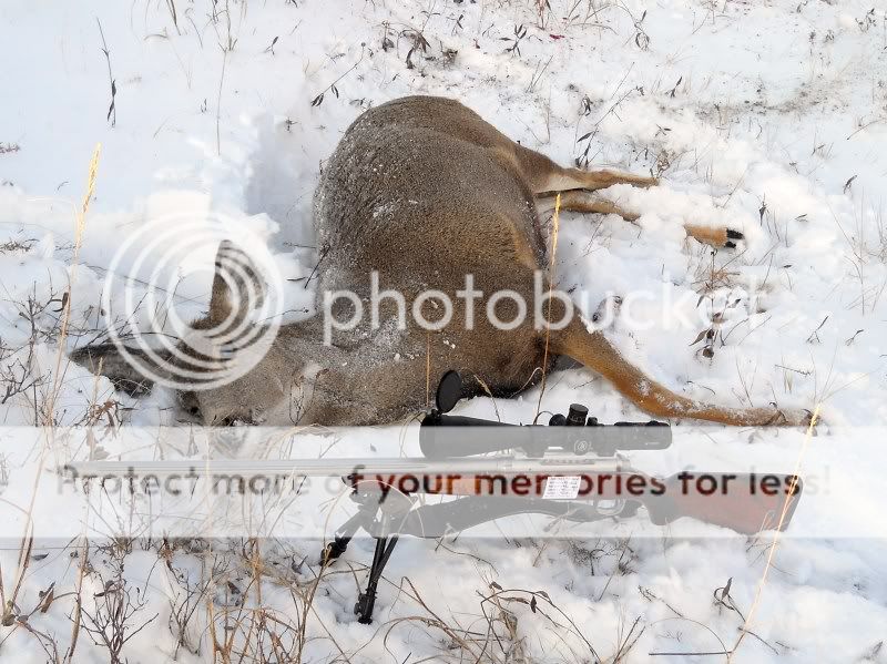

Here's a picture of a large bodied Mule Deer buck I shot at 410 yards. You can see the exit hole in the hide with this picture. So small it didn't even blow the hair out, but his vitals were turned into soup!
Same results with this Mule Deer doe at 425 yards. I actually shot her when she was bedded facing at a very hard quartering angle towards me. Went in the left side base of the neck and out the right side back of the ribs. Entrance hole is so small, you can't even tell where I hit her with the hide on.
