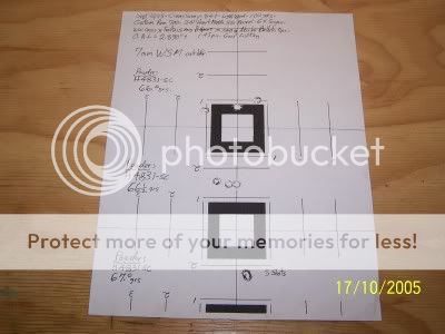

140gr 7mmwsm Rem 700/24"Hart 1/9T
Powder H 4831 SC
Win Brass NK turned & primer pocket Uniformed
140gr Nosler BT & Accubonds/CCI BR Primers
3140fps
This load is extreemly acurate was able to shoot a 3 shot one small hole under .200
load for moose used same as above but used Magpro powder max load 3290fps
group a tad over 1/2"
