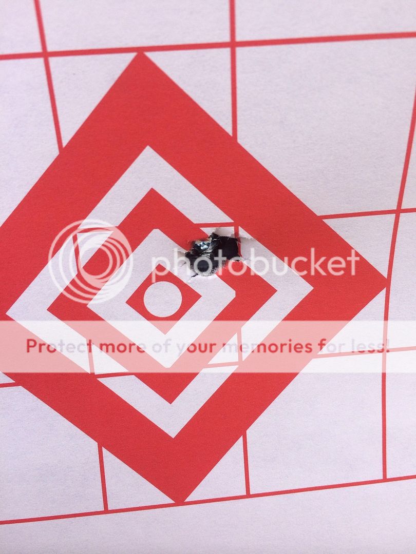

My 6mm BR 1/14" rifle is built on a Remington 700 and set up to feed from CDI bottom metal using modified 223 Accuracy Int. magazines. It runs like a champ too. Here are the first 3 shots out of the rifle at 100 yards. I worked up a load using AA2230 and Nosler 55 BTs with the same accuracy at 3920 fps.
