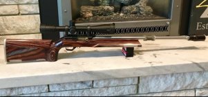

Here is what I started shooting rimfire BR with and then bult my 2nd 10/22. The 1st one was a factory receiver, a barrel i made from a Green Mountain blank, Kidd 2 stage trigger, and a factory wood stock built up with Bondo and filled with lead shot.
The 2nd build used a Pikes 80% receiver that I finished and threaded. Kidd 2 stage trigger, barrel is 25 in. from a F.J. Feddersen blank, shop made stock, shop made mid tuner, Harrel's tuner, re-headspaced JWH bolt with heavy bolt handle.

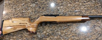

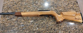

Last is a 10/22 i built my father-in-law for Christmas a few years ago. The maple came from a blank that my wife's grandpa gave me. Factory receiver that's Cerakoted, barrel I made from a Green Mountain blank, tuned factory trigger, rosewood forend and grip cap.
I kind of have a love hate relationship with 10/22's but I always find myself coming back to them. There always fun to shoot.
