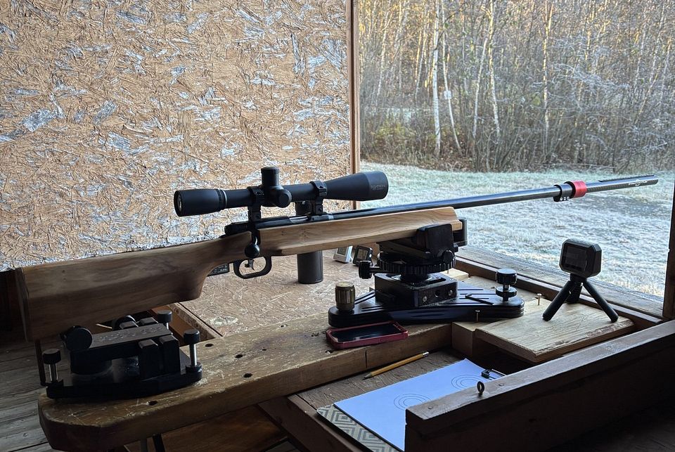

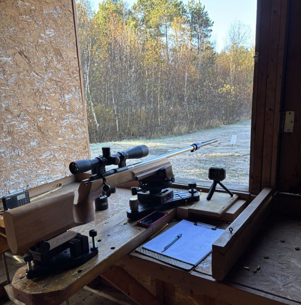

This morning I had with me at the range a new rifle I've had for about two weeks. It was calm and cool at minus 2.5 deg. Celsius (or 27.5 F). When I finished the tenth group it was minus 2.1 deg. Celsius (28.2 F).
The ten consecutive ten-shot groups at 100 shown below were all under one inch and averaged just under .700". That was pleasant surprise. The very calm conditions seem more plentiful than the two consistent boxes of Midas I used.
The rifle is an Anschutz 54.30 with a SS barrel. It is shown below as it was this morning.
