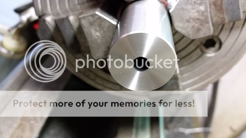

I`ve got it marked at 23" to crown. Let me know if you would like it somewhere else.
Crown is finished, multiple passes before I got it right, but it is right....!
