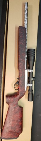

I rebuilt my squirrel getter last year for the 2nd time, & wouldn't change a thing.
Ruger action, Hogue stock, Kidd single stage trigger, Kidd Lightweight fluted/threaded barrel, Area 419 15 MOA rail, Vortex rings, Leupold 4-12x40 with the LR Duplex.
