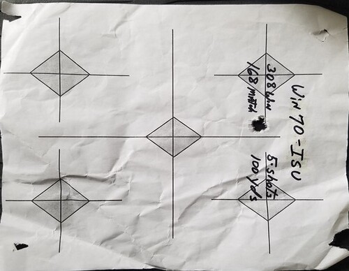

Many 308 hunting rifles were 1:10 which worked fine across most all bullet weights. In the days when the 168 match bullet was the preferred target round, 1:12 was usually selected. This is our mod 70 ISU rifle in 1:12 with 168 match @ 100 yards.
