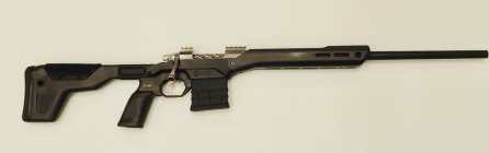

I built myself another PD gun. This time I wanted to do a lightweight “walk/ride around” rifle. Here are the specs;
Defiance anTix action
MDT Hunter Carbon Fiber stock
Jewel HVRT 1 lb trigger
24” Lija 3 groove, # 4 Contour, 1-11 twist, Carbon Grey Cerakote.
20 Practical, PTG reamer
Weight 6.7 lb
Scope TBD
Unlike the 20 VarTarg build I shared in 2022 (boy time flies) this build was more contemporary. I must say, I prefer the more traditional look and feel. Next step, make up some brass and start load development. I plan to use 32 gr V-Max bullets and start with H-4198.

A good looking rig. Would like your thoughts when up and running on the MDT. I have one,but the action sure sets low to me. Almost like an AR flat top.
Have come to prefer KRG.
Saw the notes was just curious if you were doing it that was because there was issues otherwise, I sized 50pcs new brass the other night from .224 to .204 one step through full length sizer with no problems
OIC, yes I experience excessive runout when sizing necks down more than .004” at a one time. So, I go at it incrementally since the Dillon can perform all 3 steps in a single pull. The final result is a TIR of .002”-.003” and a .200” pin gauge goes in the neck and a .201” pin does not go in the neck. Not bad I think considering the brass I’m using and the fact I’m not turning necks for a PD stick! The bottom line will be the results on paper and I can’t wait to get out there and see… Thanks for your question.
