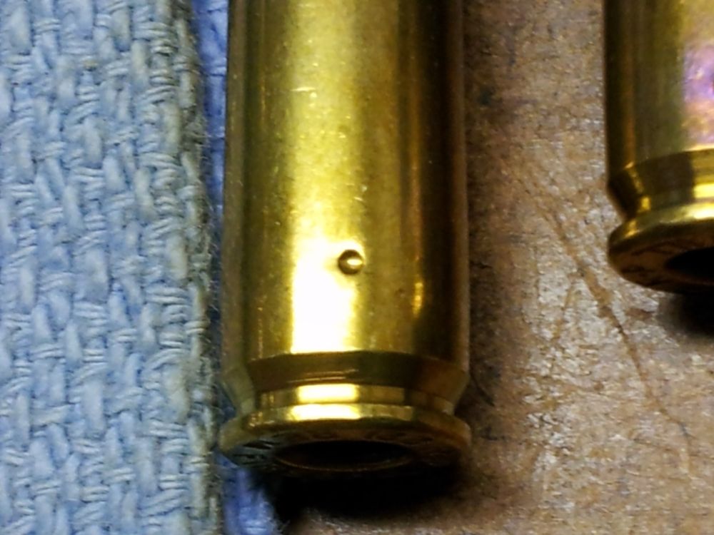

The cases on the left, and those on the right were all heated (by propane torch) during the same annealing session - for the same time, to the same temperature, and they are the same make (R-P). The only difference was the two groups of cases were made several years apart, and one group had been washed and one group had not.
Color on the body is also not an indicator.
Most people wold throw the case on the left in the trash, assuming that the head was now soft.... years ago, I did.

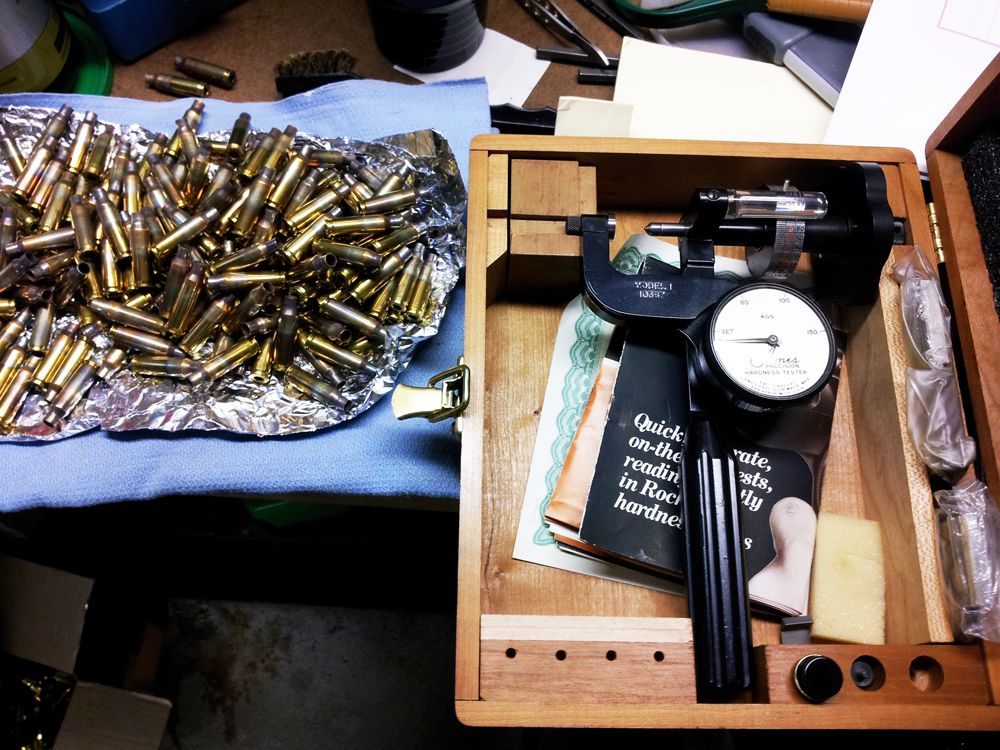

But when I bought a hardness tester, it opened my eyes - the head on both cases is exactly the same hardness...
I heat my cases so the necks are a dark red for 4 to 6 seconds, and then drop them on crumpled aluminum foil so they can cool.
Will the tester work on a sectioned piece of brass from the neck or does it have to be thicker?
It will work on thin sections - I am collecting a bunch of cases from my "rogue's gallery" to test. I also have a fairly good IR thermometer. I will first test a large piece of sheet brass with silly paint, to use as a base line, cuzz polished metal does not always read accurately with remote IR readers.
