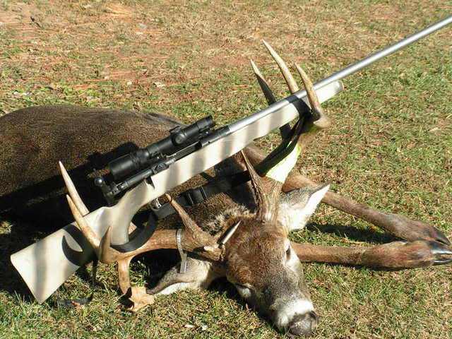

Another 25-204 fan, it is a clone of the 257 Kimber with no fire-forming and over the counter dies. The only fly in the ointment is that it won't fit a Mini Mauser, CZ-527 or Sako L-461.
25-204 w/100gr Partitions at work
