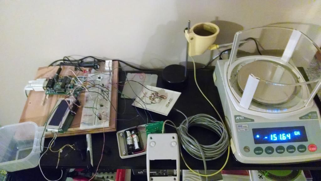

Pretty cool, using the "printer" function to feed a comparator controlling a variable speed driver for a trickler.
Below are a few videos of my automated A&D scale -- nothing special just figured I would share.
Using a PIC16F876 to run the "dispenser/trickler" and PERL to interface the scale and the ucontroller...creates logfile for each charge...i'm ok with +/- .02 from target.

Couple of videos from initial run -- code is a bit more sophisticated now so it is slightly faster than in the videos.

I have been working on my version also. I have one working with the Arduino and one with a TI C2k controller. The C2k is a much better setup so far, to many irons in the fire at the moment though.
