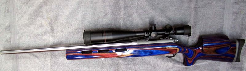

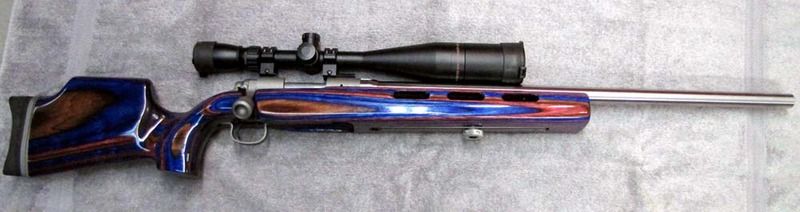

Chambered in .222 Remington. 6 months of work, sanding dust, worn out fingers and much help from some excellent friends without whom this would never be. This rifle started out as the first rifle my dad ever bought. Somewhere around 1955. It had been neglected and abused by other family members until I rescued it.

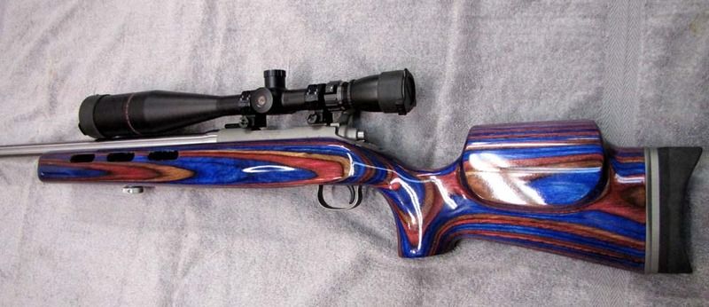

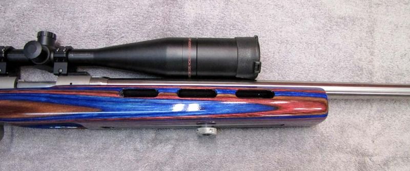

Remington 722 action, lapped bolt lugs, Mcgowan RemAge barrel & nut, Kimber hand stop, Morgan adjustable butt plate, Brownells oversized bolt handle, Richards Microfit unfinished laminated stock, (drop in - NOT) Ceracote Titanium metal paint, Ceracote clear wood finish (15 coats) Barrel is free floated, action is pillar & epoxy bedded.
Sightron SIII 6 ~ 20 X 50 riflescope. Trigger is original 1955 (no lawyers) reworked to 1 1/2 lb.

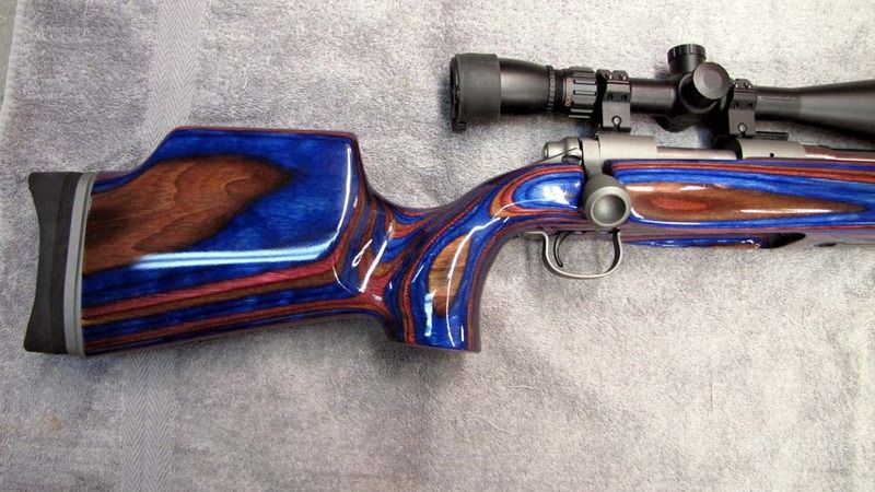

The Ceracote clear yields a VERY hard finish. There are 15 coats of Ceracote clear with wetsanding after every 2 or3 application. 320- - 400 -- 600--1000 and then power buffing. The buffing with polishing compound took a long time as the Ceracote is hard hard hard. BUT it resists scratches and abuse.
This rifle is made to be used not to be a safe queen or wall queen. There is about a months work of work just in the Ceracote application and finishing.
