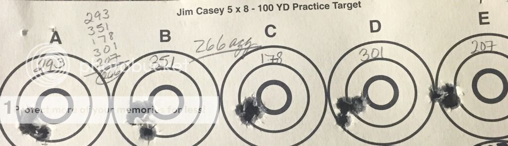

Yes that one had a tuner on it! I was disappointed it didn't do better! I'll keep working it! I shot cartridges that I had loaded for a match and wanted to see what they would do.
That was with my Dasher on a Scarbrough stock with a Krieger barrel. I the three low shots killed the agg. I will try and tighten that up.

Looks like you have the new dasher up and running.
I'll go first! Nothing impressive, but a 266 agg.
looks like you have that new dasher up and running good...
Any ideal why the one shot in 3 of the groups dropped out the bottom?

The three dropped shots were in the load. Nothing to do with bags, conditions or anything I should or shouldn't have done. The only group I hurt with the 5th shot was the last group. I over held on the last shot. That one was on me.

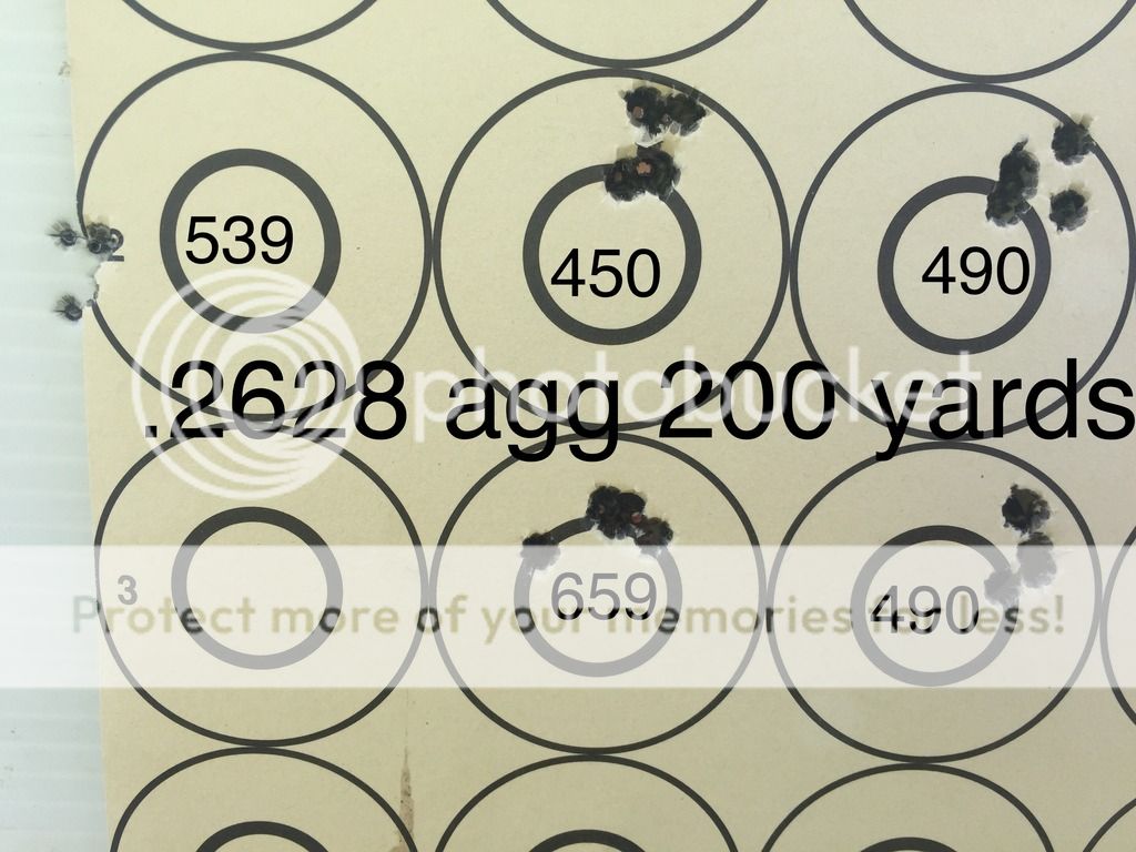

I took the Dasher and the 105s out to 200 yards today and shot an agg. Winds are 15mph plus and switchy. First group a couple of the shots got blown off paper. I had to go down to the target and measure that one befor I took it down. Much happier with the gun today. I thought it shot extremely well for the conditions. I had a couple of heartbreakers. The 3rd group turned into a 490 but the first 3 were a 204 you can see them at 1 o'clock on the mothball. The 659 had 4 into a 316. Ahhhh what could have been! That's an uncut unvarnished .2628 agg.

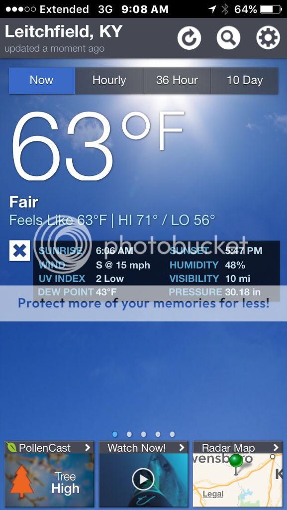

Screen shot of the weather just encase you thought I was kidding
Bart, out of curiosity do you think you would have agg'd better if you were shooting your ppc that day in those conditions?
