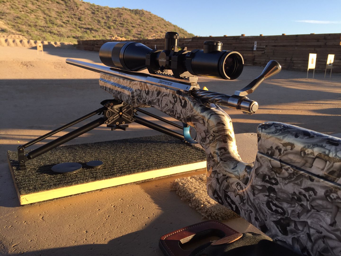

Just built a .223 For FTR. Wanted to improve my wind reading skills so this is my rig. I shoot it at 500,600 Mid-range and 800,900 & 1000. At 500 it hammers see picture below. At 800 and 900 i dropped 2 points on each string. 1000 yards became tricky but it still shoots great if I do my part. I attached the 1K photo too.
Specs
Bartlein 32" HV Palma 1-6/7 twist 5R
(Barrel work by Scott Harris)
B&C A5 Stock - modified
Timmey 1.5lbs trigger
Duplin Bipod
Nightforce Scope
Defiance Action
Bullet - 90VLD
Brass - Lapua - Into my second reload brass is fine , primer pockets fine.
Powder - 24.3grns VARGET
FPS - 2820
