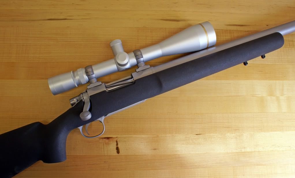

I expect someone will favor each and every stock available, but I sort of stumbled into the HS Precision tactical stock and really like it. It works with a bipod, offhand, prone with a sling or off of bags. It accommodates a magazine, but my action is a single shot. It's pretty stiff due to an aluminum spar ...

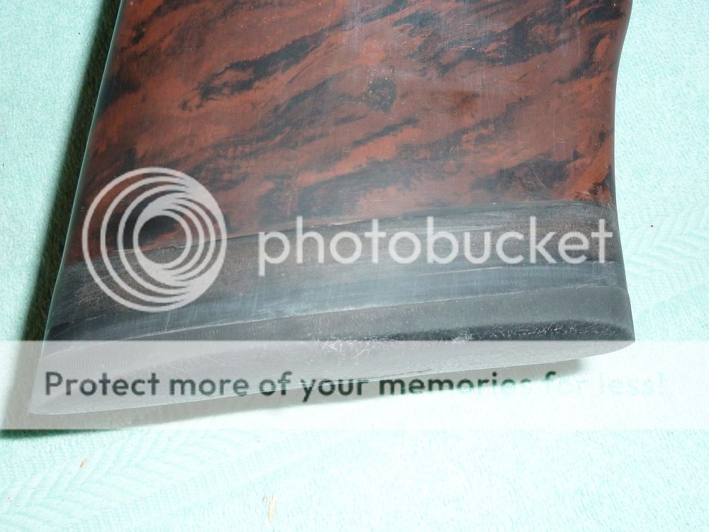

Just a potential heads up. I had ordered a McMillan stock for my Sako L461. I ordered 14.0 LOP thinking they would make the stock 1/2 longer (got the 1/2 Decelerator pad). My stock came out of the mold 13" long (they couldn't make it any longer) so to get the 14" LOP they added a spacer. Now I had a nice McWoody stock, ugly spacer, 1/2 decelerator pad. I called the, they said they should have told me they would have to add a spacer. So I sent the stock back, they removed the spacer, and returned the stock to me (no cost to me, but gone for 5 weeks). With your color combo, if they need to add a spacer, not sure how it would look?
[URL=http://s860.photobucket.com/user/jepp2/media/Stock%20Extension_zps9jify3if.jpg.html][/URL]
Could have just added a 1" recoil pad to get you to 14"..........................:confused:
