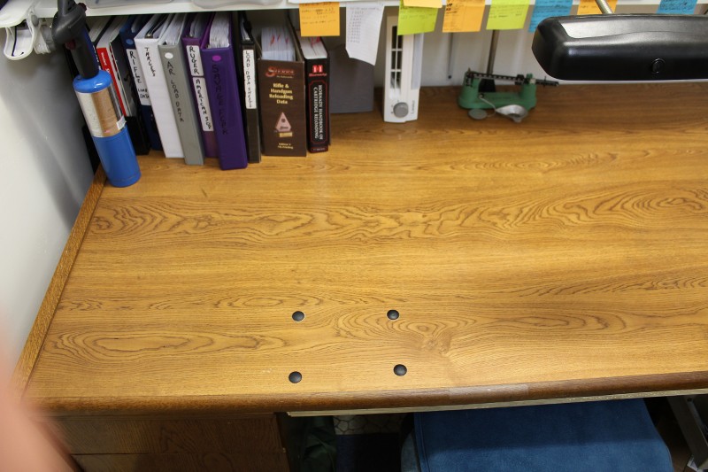

    I drilled 4 holes through the desk/bench and put black caps in them when not in use
    [​IMG]
    On the under side I used these nut like things that permanently counter sink into the wood
    [​IMG]
    I then mount different tools to 3/4" pieces of wood that can be bolted to the desk/bench
