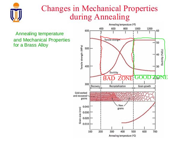

    The orange flame is not because the temperature is 750°.
    The orange flame comes from the oxidation (burning) of carbon... carbon in the neck, from oil, or wax from preservatives on the new case, etc.
    It NEVER comes from oxidation of copper, Zinc, or tin... never! This is a fact of chemistry, not my opinion. Copper, Zinc and Tin all show bright green in the flame when they oxidize, and for any of them to oxidize, they must hit a temperature way hotter than melting point of brass (like above 3,000° F.).
    The zinc does not break down, since it is a basic element, there is no "down" to break to.
    Zinc 787°f
    Copper 1984°
    Tin 449°F
    70/30 Cartridge Brass - 1,700
    When metals are alloyed, they lose their individual melting points... so when you heat brass, the zinc does NOT melt out at 787°F... the whole piece of brass melts at ~1,700°F.
    If you look at this chart on annealing brass, it shows that 750°F is probably the worst temperature us use. It is right in the middle of the steepest "rate of change" on the annealing time/temperature curve.
    The curve straightens out around 900°F
    [​IMG]
    It turns out that 900°F in brass is the temperature that brass turns dark red. So it all comes together to be an easy, self controlling system without a need for a lot of technology. Heat it to dark red - time is not critical, 'cuz the curve is flat, and then you are done - no messy templaq.

    Actually that chart at least to me indicates 750* is perfect . Keeping in mind this is rifle cartridge brass and not just a hunk of brass that needs annealing .
    The cartridge brass needs some hardness left in it to hold the bullet and to give the cartridge structural integrity . I have to say what I've shown as far as over annealing ( likely in the 900*+ range ) resulting in poor bullet hold and the other guys saying there over annealed cases collapsed on chambering or sizing has shown that hitting a temperature well over 750* when annealing cartridge brass is not a good thing .
    Your chart clearly IMHO shows that sweet spot cartridge brass needs to be at as those two line intersect . At least that's how I see it . The brass in that zone has gotten softer but not so soft it can't be used safely as cartridge brass .

    The reason that we do not use 900 degrees it that we do not want to fully anneal necks, because we need some bullet pull for best accuracy. Powders vary in this requirement. The object is not to fully anneal, but rather to put cases through a process that increases the consistency of velocities. Actually... using the word anneal can lead people astray. We do not want necks to be fully annealed.

    Please remember that there is also a time element in all of this. If you go to 750 and air cool you might be in the same area as 900 (dull red in a dark room) and an immediate water quench.
