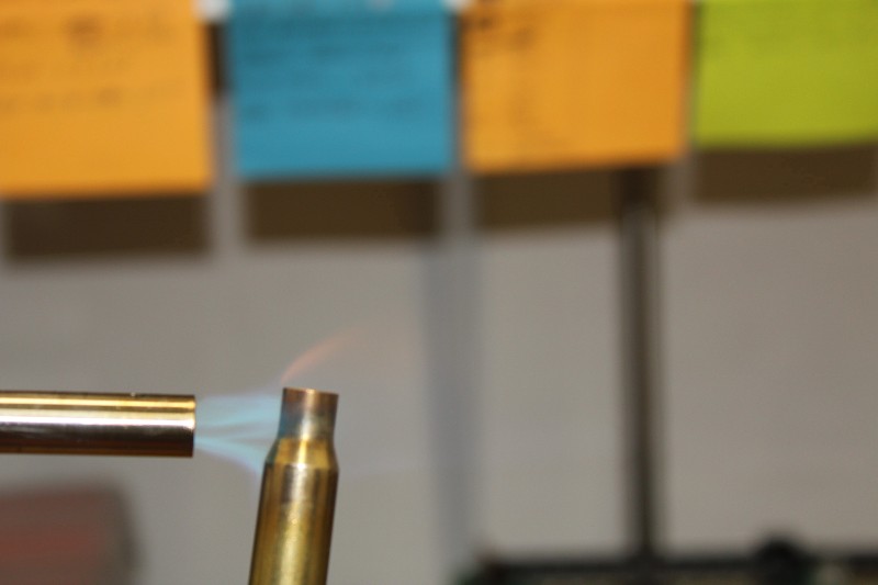

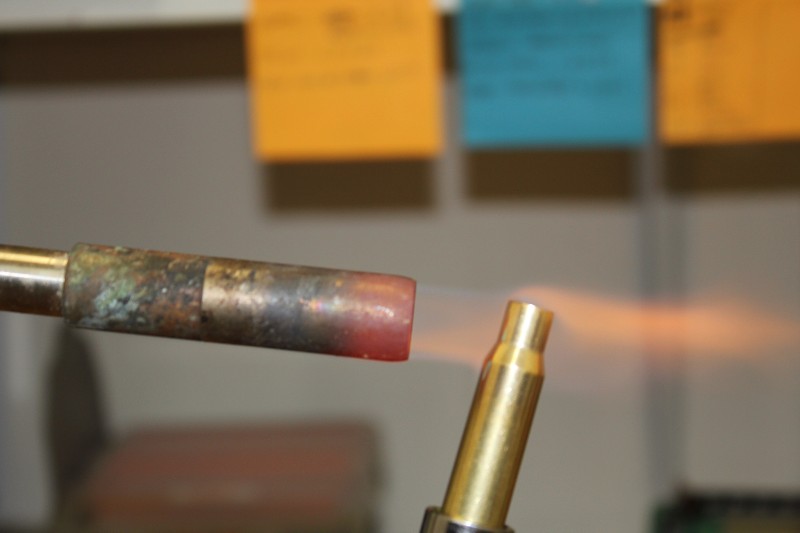

  13. Metal God
    Metal God
    Joined:
    Dec 9, 2017
    Messages:
    81
    haha yeah based on how hot you get the case . It's not like each machine has a time it takes to anneal any case at any torch setting with any type of gas used . Yes they are time driven but that's just cus .
    FWIW I'm not trying to make things difficult . I did these test to understand what was going on when annealing . It got confusing after awhile hearing so many people say so many different things about annealing . I figured instead of trusting one of many opinions I'd just test this stuff my self .
    My test showed a propane torch turned down a bit will give more consistent results as far as the brass consistently reaching the same temp each time . I tested a propane torch at multiple settings ( different intensities of flame/heat ) and compared that to using a MAPP gas torch .
    All these photos below were taken the moment the 750* temp indicator melted inside the necks
    This flame took about 7 or 8 seconds to melt the 750* temp indicator inside the neck . I got lucky and caught the 450* on the outside melting at the same time .
    [​IMG]
    This flame took just over 5sec to do the same .
    [​IMG]
    Will this MAPP gas flame only takes 4secs
    [​IMG]
    As you can see your timing is proportional to the heat of the flame
    gunsandgunsmithing likes this.
