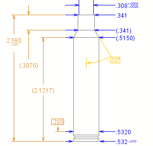

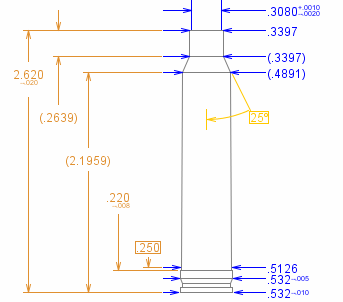

I ran this through AG's rechambering tool and they're saying it's not just a straight up job but there's a workaround.
My number crunching says at least .075 setback.
.300 Winchester Magnum
.300 PRC
Yes it would have to be set back some.
Yes there's a set back, Dave stated it in the second post and I agreed although I didn't write it out, when I posted the drawings. Practical, hands-on experience dictates that set backs are a common procedure and like some assumptions, I skip over those words:oops:. I would go a bit farther because of the throat and freebore length.
