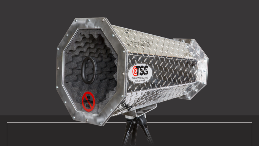

Thunderbeast would be my first suggestion...
I think you have something more along these lines in mind though
I have seen used tires used to form a tube to shoot through. Logic would suggest the longer the tube the more noise reduction. I can't personally report how much sound baffling you can expect.

I did notice that one system made of aluminum checker plate and that is what has me leaning towards a tube type setup.. I have also noticed some european shooters utilizing a pyramid type system about 2meters long just in front of the muzzle..
I will try searching on youtube as suggested so I can maybe have a better idea as to what I can expect for actual noise reduction.
