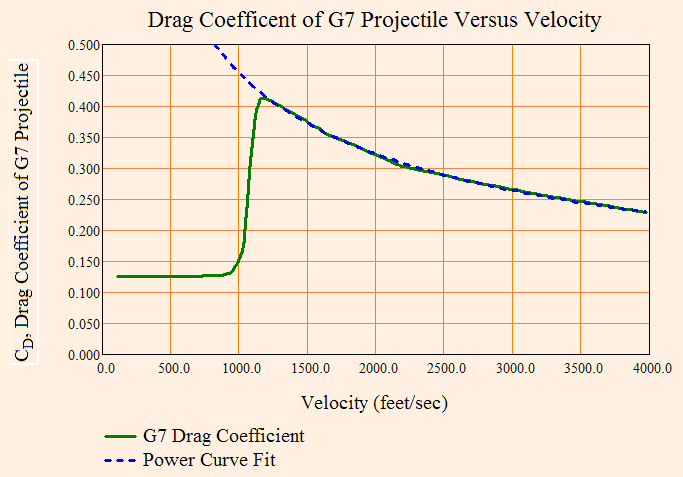

If you look at a chart of drag coefficient vs mach number for a bullet you see that it's very well behaved over mach 1.1 or so, and below mach 0.9. In between, all hell breaks loose. That hell is the transsonic region. Notice the HUGE jump between 1000 fps until about 1200 fps. Before and after it's basically simple, easy to predict curve. In between all bets are off. (That's an oversimplification, but you get my drift).
