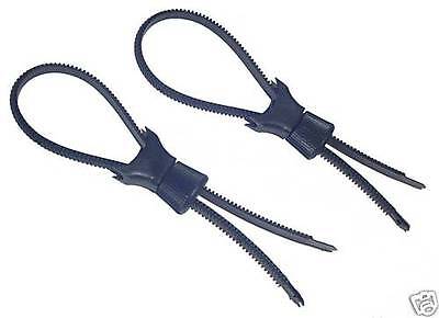

I use these on my scopes. Simply tighten down and cut off excess length.... about $7-10.00 each
https://www.ebay.com/itm/Breakaway-Plastic-Coasters-Sea-Fishing-/253091408896?hash=item3aed6c6c00
