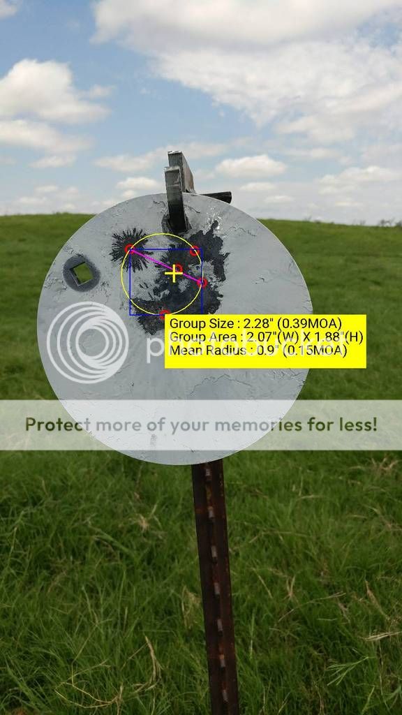

  16. NortexDM
    NortexDM
    Joined:
    May 12, 2016
    Messages:
    22
    Not exactly 600yds but 555yds 5rd group with 105 rdf's. These are jumping around 30thou and going 3003fps from a 6 creed. Conditions were less than ideal with very heavy mirage to try at 1000 but connected on a 1 moa plate cold bore with the advertised .280 bc.
    [​IMG]
