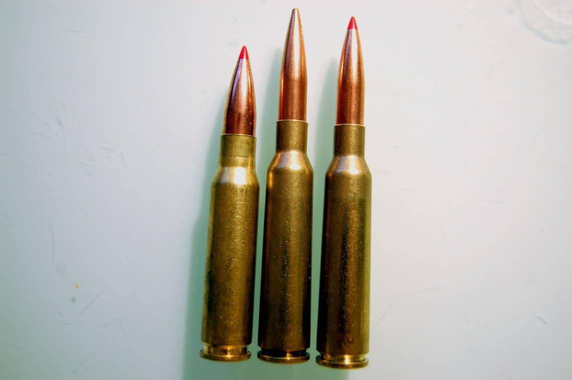

168 Amax 30 cal next to 140 VLD and Amax in Swede
