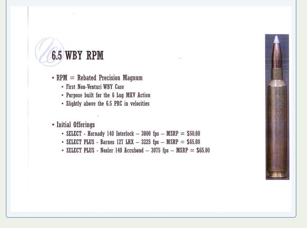

Weatherby is going to introduce the new 6.5 WBY RPM cartridge on Sept 1st, it basically looks like an extended 6.5-284 with the rebated rim and a 35 deg shoulder angle, specifically designed to be used in there 6 Lug Mark V action line up, looks like a good cartridge.

Actually more than a 6.5-06 Imp. because it is a rebated rim, so more like a 6.5-284 "stretch" or limo, so it will have more capacity. It appears the factory ammo is mild, which is as much out of the box for Weatherby as offering a cartridge w/o a belt and w/o their famous shoulder, their ammo is usually pretty warm. But really all they had to do was show this round to be a tic faster in potential than a PRC, I believe they will do that, as the PRC and 6.5-06AI are very close if both are chambered correctly and loaded to same pressure.
This new round if done correctly should be just a little slower than a .264WM, a good place to be. I sure won't be selling my 264 anyway soon.
Maybe Weatherby has learned from the current marketing pros, Hornady, we shall see. If they offer the ammo at a decent price and the brass I think it will take off when you consider there are guys like me with '06 case head actions laying around, I think the brass sale potential is large. One of the main goals was to have this round in the smaller, lighter 6 lug action but they offer in the Vanguard (likely) and one or 2 other brand rifles come out with it, I believe it will take off.

I talked to Weatherby the other day about their new 6.5 RPM
The case length is 2.570 and case capacity is 81gr H20 which is just a little more than what a 6.5WSM is and quite a bit more than a 6.5-06AI.

With wildcatting a 6.5 cartridge, sky's the limit. Sensibility is key when cartridging any caliber. If it's sheer velocity that's the hook and barrel life means nothing, go for it. Accuracy, velocity and barrel life all go hand in hand IMO. Barrel life meaning the least. Accuracy meaning the most. According to Weatherby, the velocities are 3000 fps with 140s. That's a very modest number for that cartridge. One that shouldn't kill barrel life immediately. Push it to it's maximum potential and like Frank said, it's toast, fast. It's really user preference. All the barrel makers love their customers. Especially when they go thru barrels after 500-600 rounds.

The .264 Win Mag has a case capacity of 82 grams of H2O.
Based on the near-equal case volumes, it seems the 6.5 RPM will have ballistics almost identical to the .264WM, but in a more modern case design.
