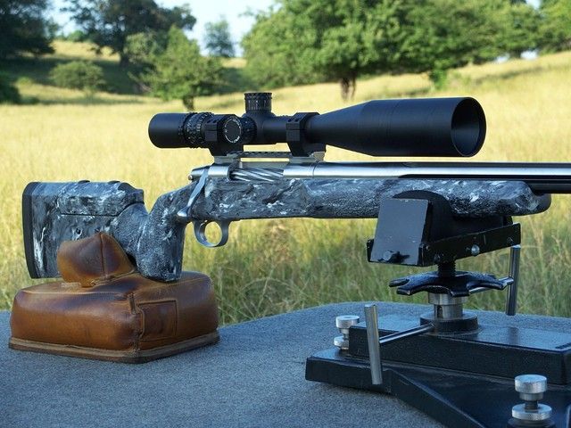

I ordered a new SPS 25-06 for the donor, tore it apart, found a Bartlein 3B 8" twist in stock, and sent it and the action off to get chambered and fitted. I picked up a used McMillan Sporter stock, sent the bolt off for fluting and tig welding, and cobbled it all together when things came home. Managed to topped it off with an extra NXS 5.5-22x50 Nightforce in Seekins rings and 30 MOA bases:

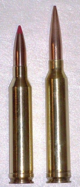

7Mag w/162 Amax vs the 7x300 w/183 SMK....

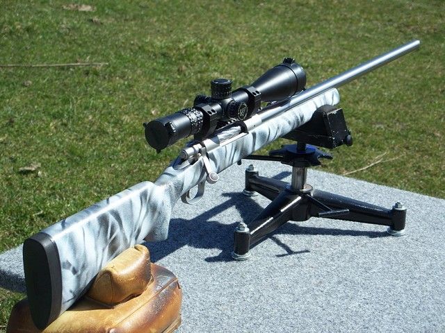

The used stock was for a HV contour, so I fiddled around and filled it in with 2 part epoxy/micro baloon mix to better fit the RV contour, and bedded the action:

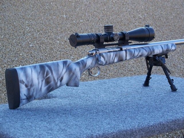

Then had to address the OD green paint. Decided on a snow camo motif:

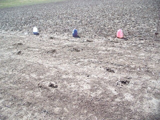

Filled up some more jugs with colored water:

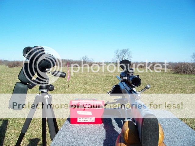

Backed up a little bit and got set up:
Not really the best day to be out there, as it was cold with the winds huffing & puffing more than predicted. But worse yet, it had rained a little bit, which made spotting impacts sketchy at best. The bullets were just bombing out little divots. Managed one kill for my effort though.

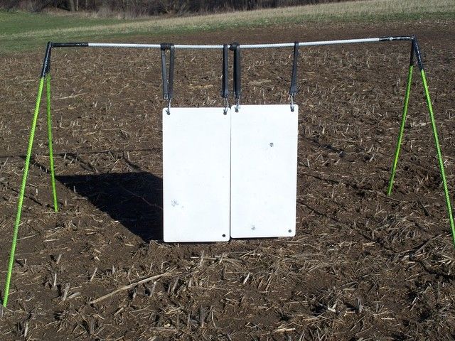

So I dialed in 56 MOA and took two sighter shots in the dirt to foul the bore and get a wind reading, then moved over on the 24" square (12x24 each) steel.
First shot was the low/left hit, next was the low impact in the dirt just below it, 3rd was the upper right hit, 4th was just a RCH left of the steel (in the shadow), and 5th was the low right hit. I'm calling it around a 24" group. Not bad consider the head on blow.

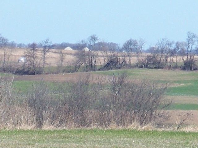

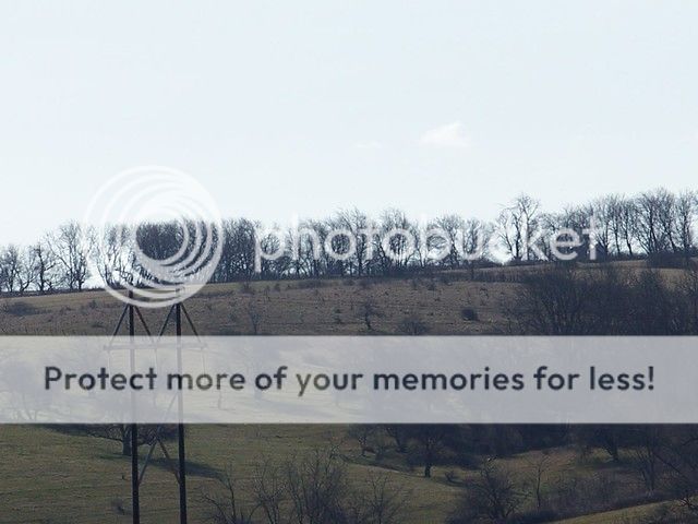

Looking back:

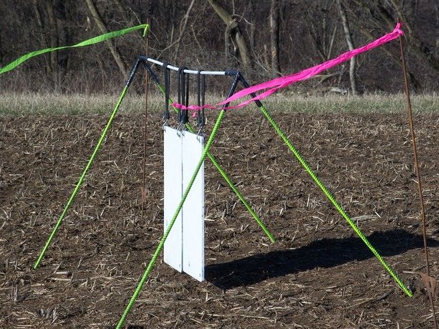

Set-up was at the back treeline in the gap three quarters of the way to the right by the tallest tree....
