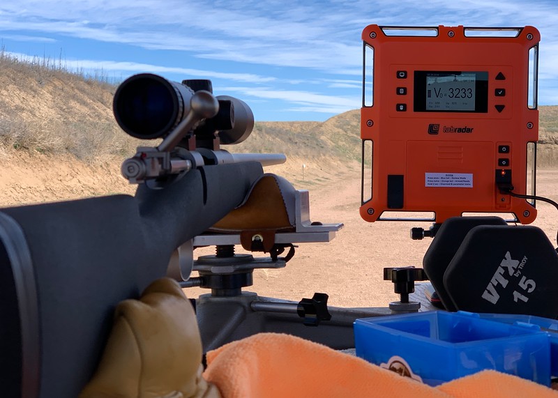

LabRadar is the Cadillac of chronos. Super accurate and it doesn't touch your rifle. There is a bit of a learning curve, so it is a little more involved to run than the Magnetospeed. But, once you learn how to run it, you easily get super accurate velocity data without disturbing the rifle's POI or possibly changing group size.

Get the Labradar no clamping to the barrel with adjustments necessary for different rifles no going downrange to setup a tripod with old school chronos.

If you're considering the LabRadar I highly recommend doing your research. They're a great "idea" but unfortunately they don't always work as advertised. Don't just read or talk to the people with good reviews. There are a lot of VERY frustrated LabRadar owners out there and for whatever reason the LR drops or misses shots, sometimes frequently.

Anyone interested in extreme data for your velocities the only way to go is LabRadar. There is a significant amount of data that the unit records and stores other than the minimal data shown on the screen. The data is stored on an SD card and can be accessed from the card to a computer with either the LR attached or a card reader. For instance velocity data for each shot in a shooting session a CSV file is created. I just looked up a single shot from a 30-06 fired at a range of 115 yards and it gave me 111 separate velocities along with the range for that single shot. So you are able to analyze in great detail every shot you fired in any given session. The data also reflects the amount of time expired from the time of the shot to each recorded velocity reading. So for a data freak like me it's the only way to go.

If you go with a Labradar, buy this kinetic trigger and missed shots will be a thing of the past.
